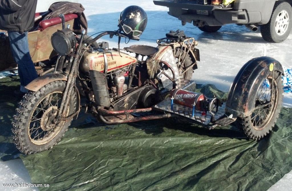

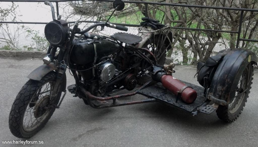

Kraftigt modifierad 1926 Harley J,
Den har gått som backracer på 50talet i Stockholm och sidovagnsramen är sänkt 15 cm redan då.
Modifieringar på engelska:

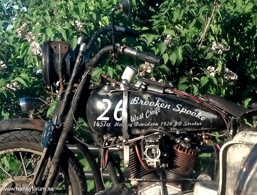

Technical data:
Stroke 1457cc or 86" cui aprox. 40 - 50 hp
1928 JD engine case
Truett & Osborn flywheel 4" 5/8 stroke
High compression pistons
Jims tappet and rollers
Am Bosch ZEV magneto
Kehin CV 40
4 speed 1978 Electra Glide Gearbox
18" wheels (19" now more)
Fat Boy Disc brake rear
AGA gas light
Drum brake front (no front brake now more)
Sidecar lowered 7" inch
Special high compression pistons are blue printed.
The standard rods are renovated and checked for cracks and straightness.
The flywheel from Truett & Osborn have a stroke of 4" 5/8 inch that gives the bike a 86" cu inch or 1457cc engine and approximately 45 horse powers.
Offset rocker arms gives some extra horse power and torque to beat the heavy hills.
New reproduced JDH 1928 reinforced cylinders will be used.
